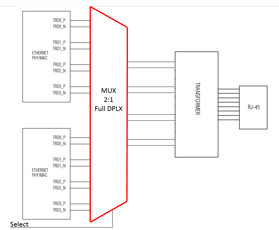

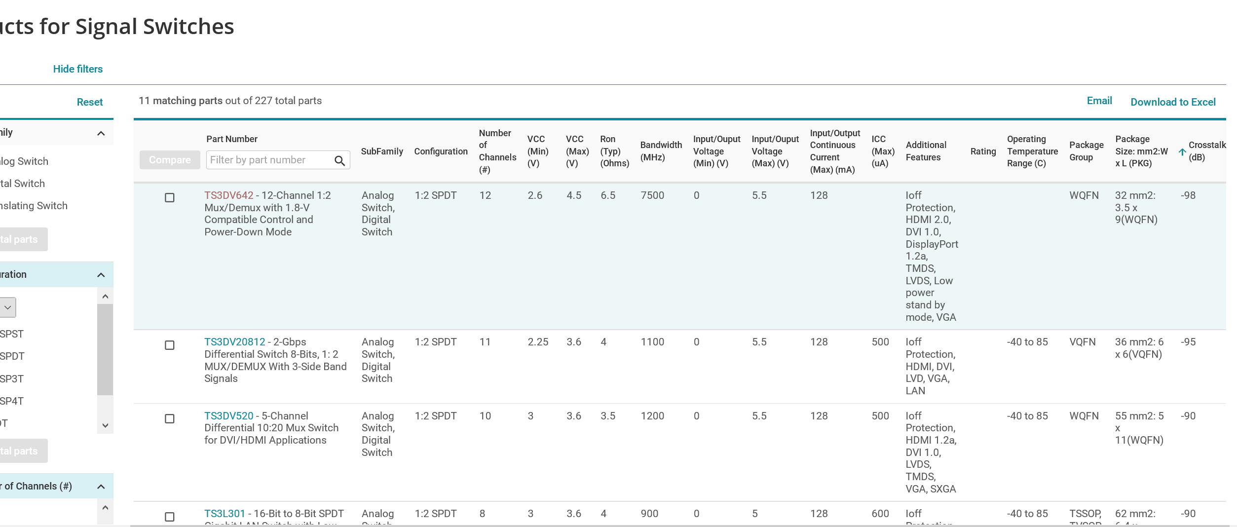

Can you recommend a good 2:1 mux for 250Mbps per pair Ethernet PHY to PHy?
Other Parts Discussed in Thread: CD74HC4053, TS3DV642, TS3L301
hello !
Posting on behalf of FAE.
These differential analog signals of PAM5 (-2,-1,0,1,2) running at 250Mbps per pair are sensitive to crosstalk.
They are 50ohms single ended and 100ohm differential ; hence low Ron will be ideal.
what is a good recommendation for the 2:1Mux.
