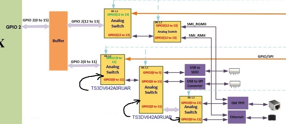

Hi
I am using TS3DV642A0RUAR switch for validating all the interface coming from one pin.
Like this i have 3 (TS3DV642A0RUAR) in the line. So can you please let me know how to check the behavior of signals coming out from the Pin mux and crossing the switches i.e. like how much signal loss will happen.
I have attached the block diagram for your reference and marked the switch along with the part number.

  • Nitesh,
    You can use the S-parameter model I found when searching for "TS3DV642 model" in the switches and multiplexers forum search bar.   This thread as one way to know the device performance and insertion loss.
    You may also use the bandwidth graphs in the datasheet to see the insertion loss.  It will be about -0.75 dB at low frequency and roll of to -3dB about 7GHz.
