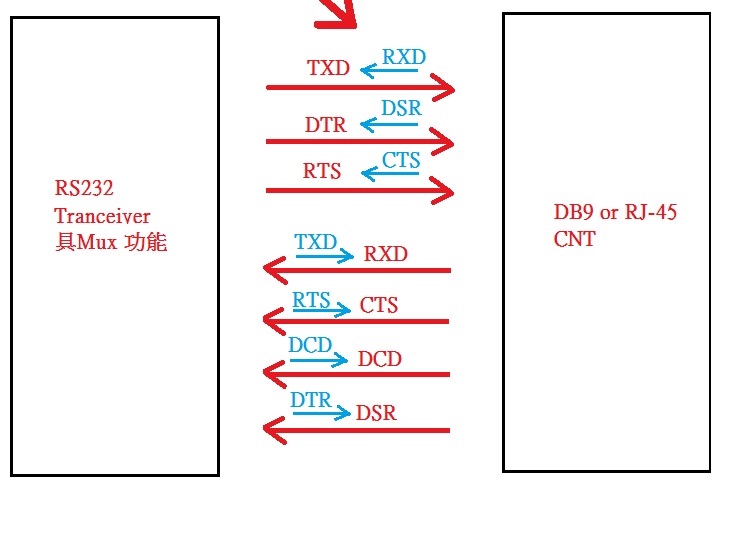

Dear Sir
I would like to find a UART Mux 2 to 1 for 7~8 channel and used for RS232
Do you have any suggest solution ??

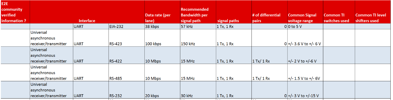

I looked at this e2e post to see what the voltage level and bandwidth of an RS232 signal looks like.

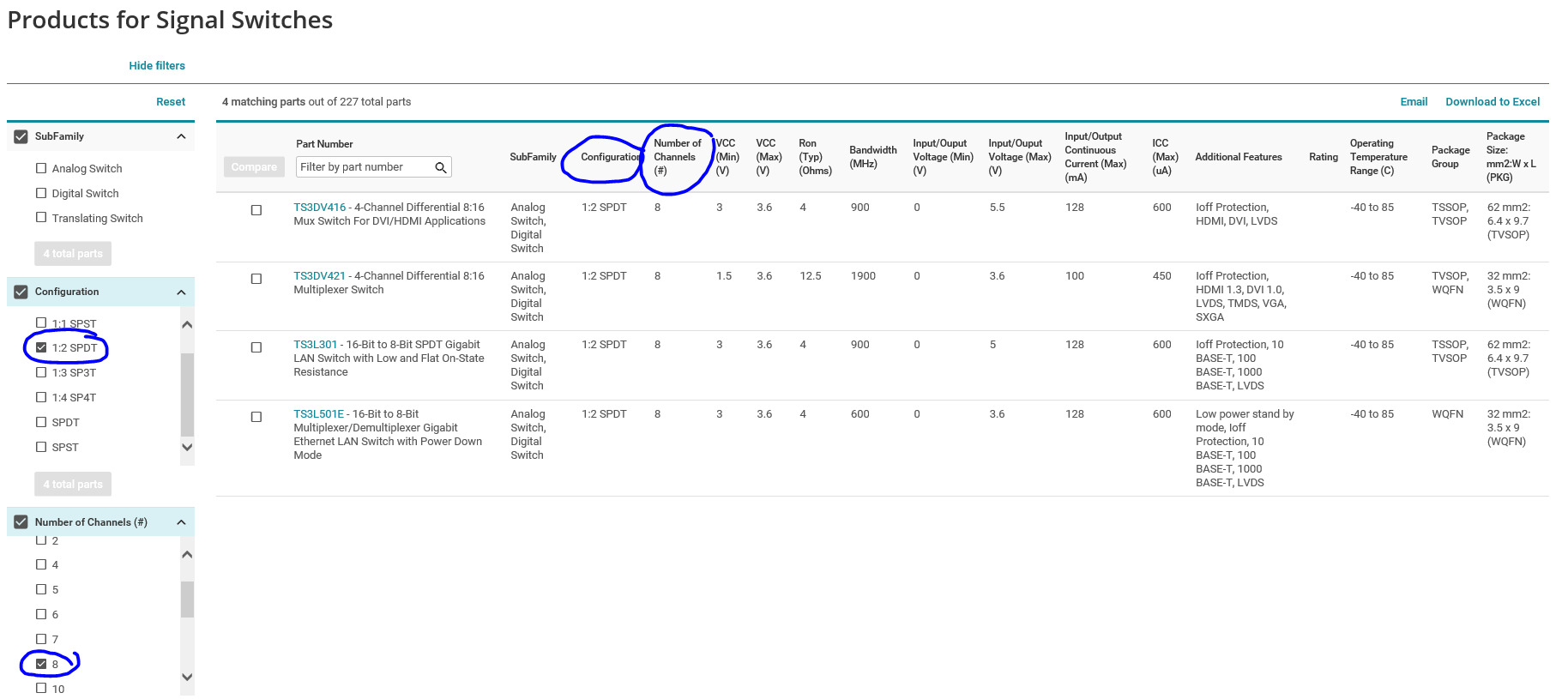

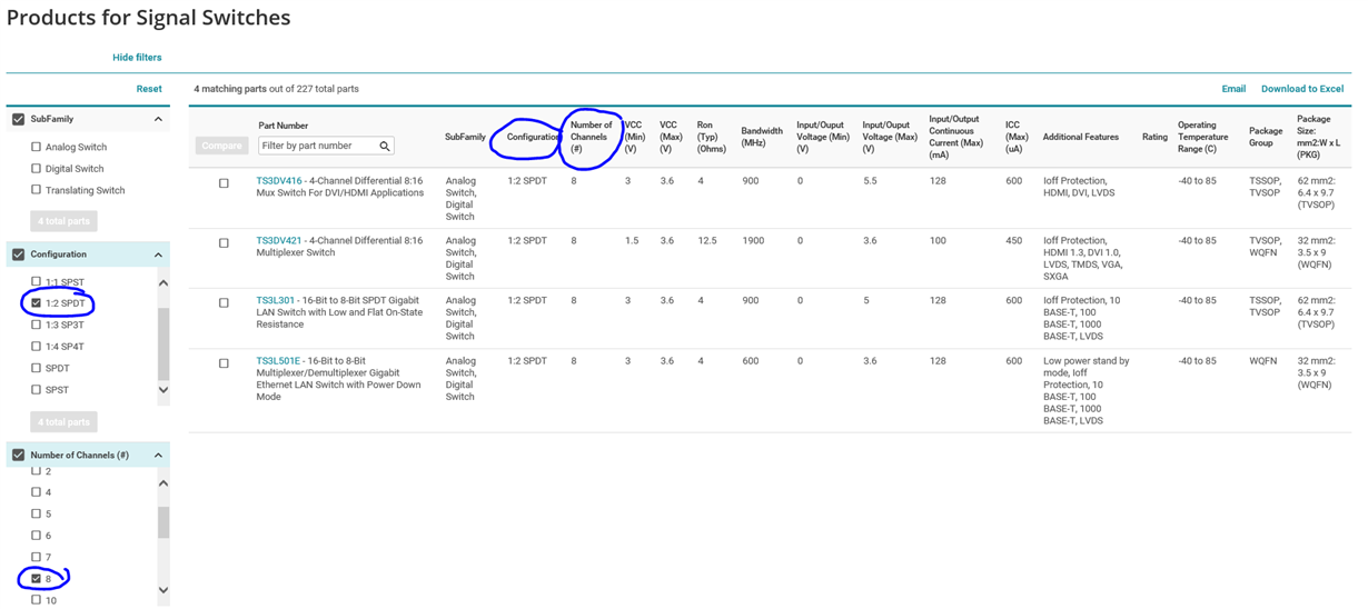

Next I used the TI.com switch selection tool and sorted for configuration "1:2 SPDT" and 8 channels. The tool returned 4 results TS3DV416, TS3DV421, TS3L301, and TS3L501E.
Let me know if these will work for you.
