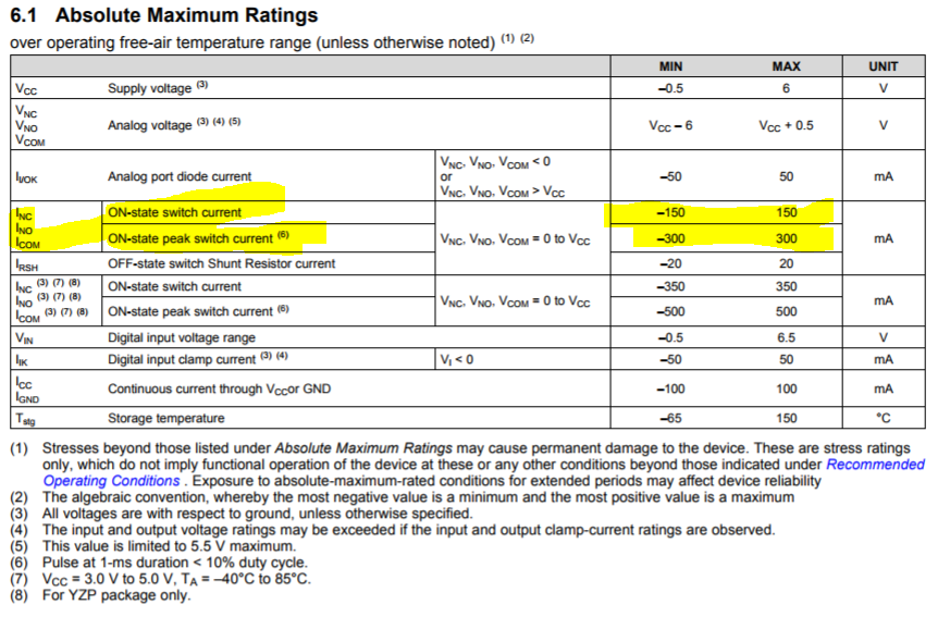

May I know how about maximum load that TS5A22364 could support ?
If SPEC Vin swing Vpp is 1.414V and output load max is 600ohm
Can TS5A22364 do this ??
    The TS5A22364's datasheet has an absolute maximum current you can run through the switch.
    The answer to your question will be dependent to the output voltage of your switch and then your load. If you do the math and the Voltage drop/Load resistance is less than the maximum current specced in our datasheet, then the answer is yes.
    Please note that there is a maximum pulse current and a maximum run current. If you exceed this, or hang out around the pulse current longer than the specified time, you can cause permanent damage to the device.
