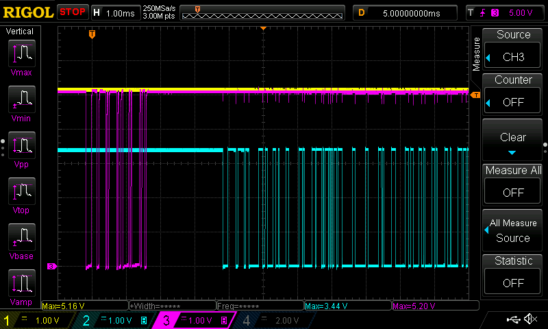

  • Here are a handful of scope captures. The test transmission was a 'device inquiry' call-and-response initiated by the host. All signals look to obey the Vcc + 0.5 V maximum rating.
    Traces are as follows:
    • Ch1 - Yellow - Vbus
    • Ch2 - Blue - Tx (Device -> Host)
    • Ch3 - Pink - Rx (Host -> Device)
    The first capture shows the correct behavior on a known good unit.
    The second, from a returned unit, shows that the system doesn't receive the initial transmission from host to device.
    Manually prompting the device to transmit shows that the device can successfully transmit to the host.
    Were these scope captures from known good or bad devices?
    When you pulled these, which pins did you measure them at?
    I apologize for not being more specific in the earlier post, I am trying to understand what could cause the device to be stuck in a specific state since my team hasn't seen this before. I appreciate your patience with me in this debug process.
    Thank you,
    Louie
  • The first capture is from a good unit and the other two are from a returned (bad) unit. The signals are measured at the midpoint of a USB cable with the cable signals broken out. I can retry with wires attached directly to the PCBA to rule out connector/cable issues if you'd like.
    • Ch1 - Yellow - Vbus - Pin 8
    • Ch2 - Blue - Tx (Device -> Host) - Pin 6
    • Ch3 - Pink - Rx (Host -> Device) - Pin 10
  • I repeated the experiment with the bad unit after soldering a USB cable directly to the USB connector traces on the PCBA and saw the same results.
    Could you provide an additional scope capture between a known good and bad unit consisting of:
    NC
    NO
    COM
    IN
    But could you prove a scope capture as IN is transitioning from low to high. Please provide a continuous signal through COM, but drive the IN pin like how you are in your circuit with your MCU so that we can see if there is proper switching between the pins, and to make sure the IN pin is being properly driven from low to high.
