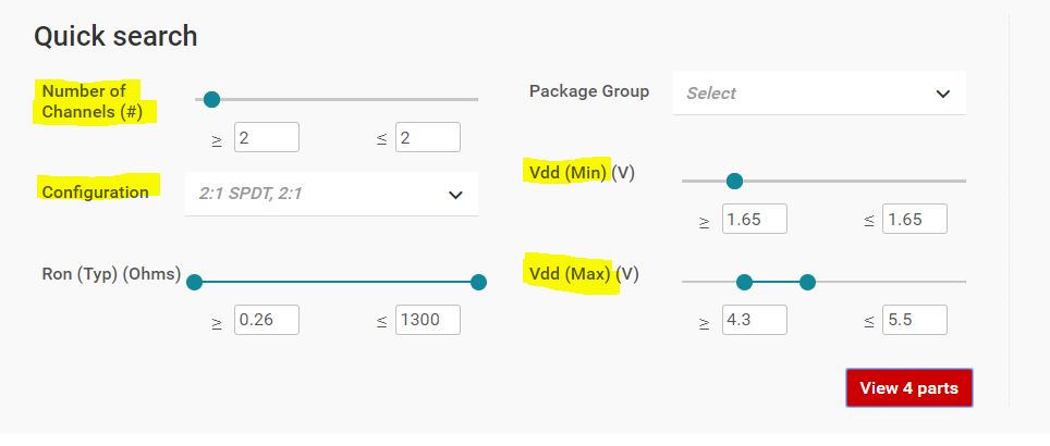

To find the best TI cross for this device, I used our parametric search available at www.ti.com/switches under the Analog Switches/Muxes “Products” tab.
In the Quick Search, I filled out the 3 top most important specifications that will significantly narrow down your search for the right switch:
This narrowed our search to 4 switches.

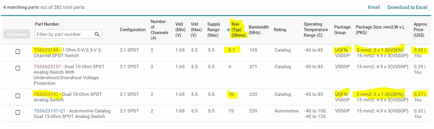

Then I sorted by lowest On-State Resistance (Ron) and as you can see below, there is a 2-channel, 2:1 switch in a UQFN package.
TS5A23159RSER will be your best cross for this competitor device, while TS5A23157RSER could be a more cost effective alternative. It should be noted that these are not exact pin for pin crosses.
