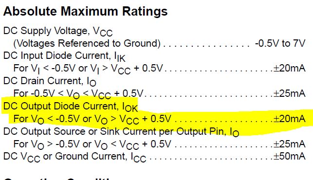

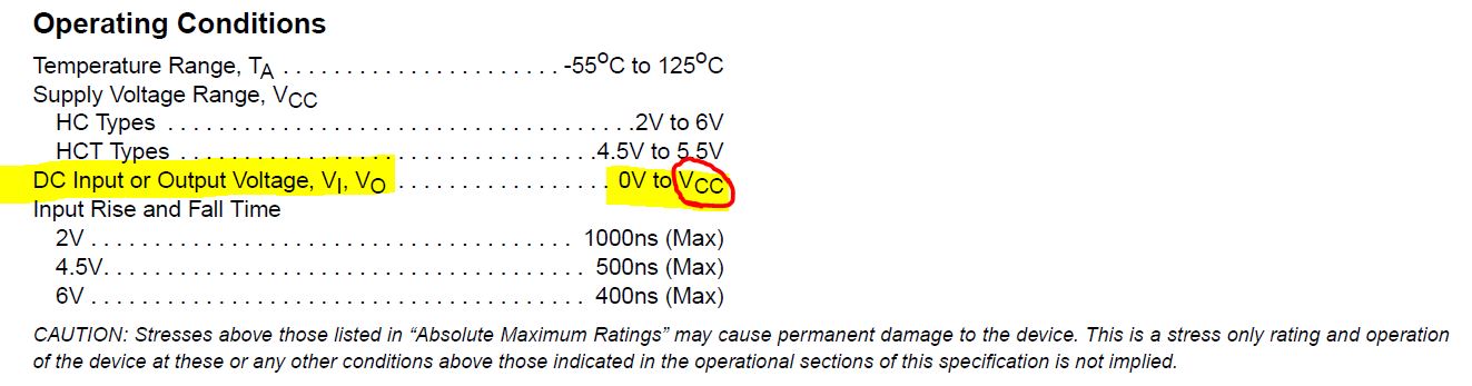

    If there is a voltage on the signal path I/O pins > than Vcc  or it will violate the operating conditions in the datasheet.  We cannot guarantee the performance specs in the datasheet if the condition is violated.
    Having voltages present on the signal path before Vcc is up typically causes the esd protection diodes to conduct and sink current through the signal path to the Vcc pin when the voltage is 0.5 V greater than Vcc.  This leakage current must be limited to 20mA or there is risk of damage or reliability of the device.
    Let me know if this leakage current is what you are seeing as peculiar behavior.

    Thanks for getting back so quickly. During normal operation the voltage on the signal path I/O pins is not > than Vcc. However not sure if this is the case during power up i.e. some of the I/P signals could be established before the 3.3V (Vcc) comes up. - it may be. Need to check.
    If this is the case then any leakage current cannot exceed 20mA as all the I/P channels are protected by input resistors.

    I have heard of power up issues with signal switches where the voltage on the signal path is greater than vcc or below ground causing large amount of current to flow through the device causing damage but it might not be the case since you say you have the current limited.
