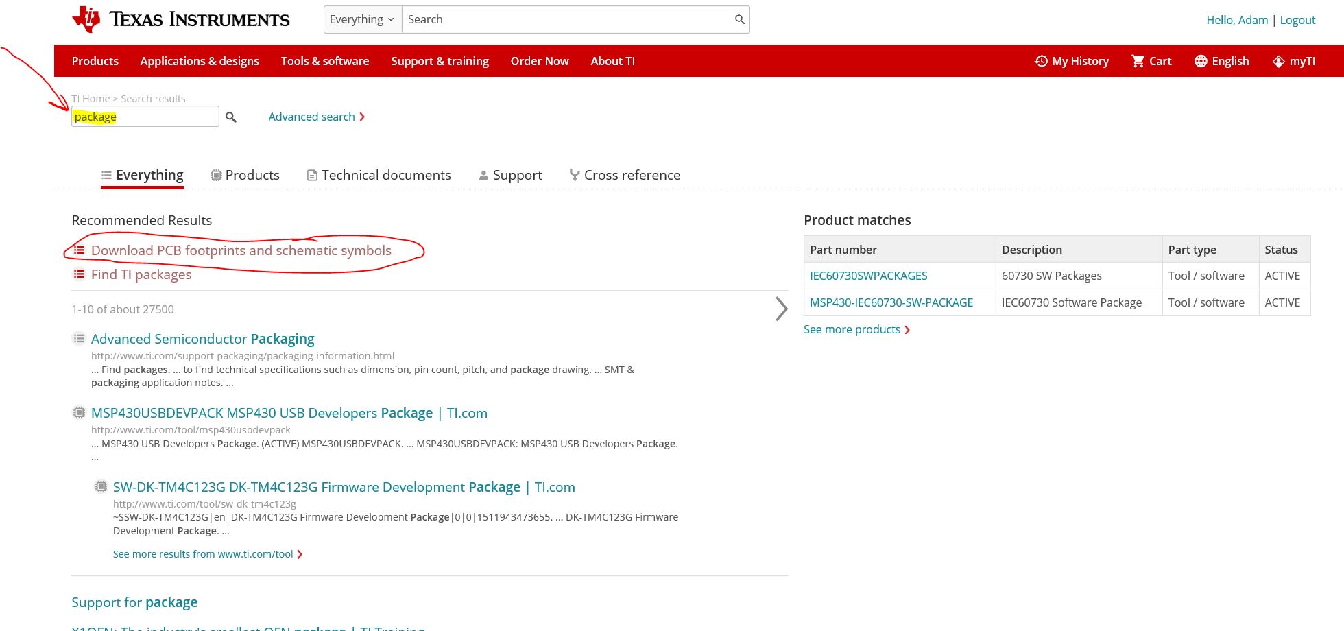

There are many PCB footprints and schematic models on TI.com. To find a 3D SETP file, I went to TI.com and searched the term "package" and selected the link "Download PCB footprints and schematic symbols.

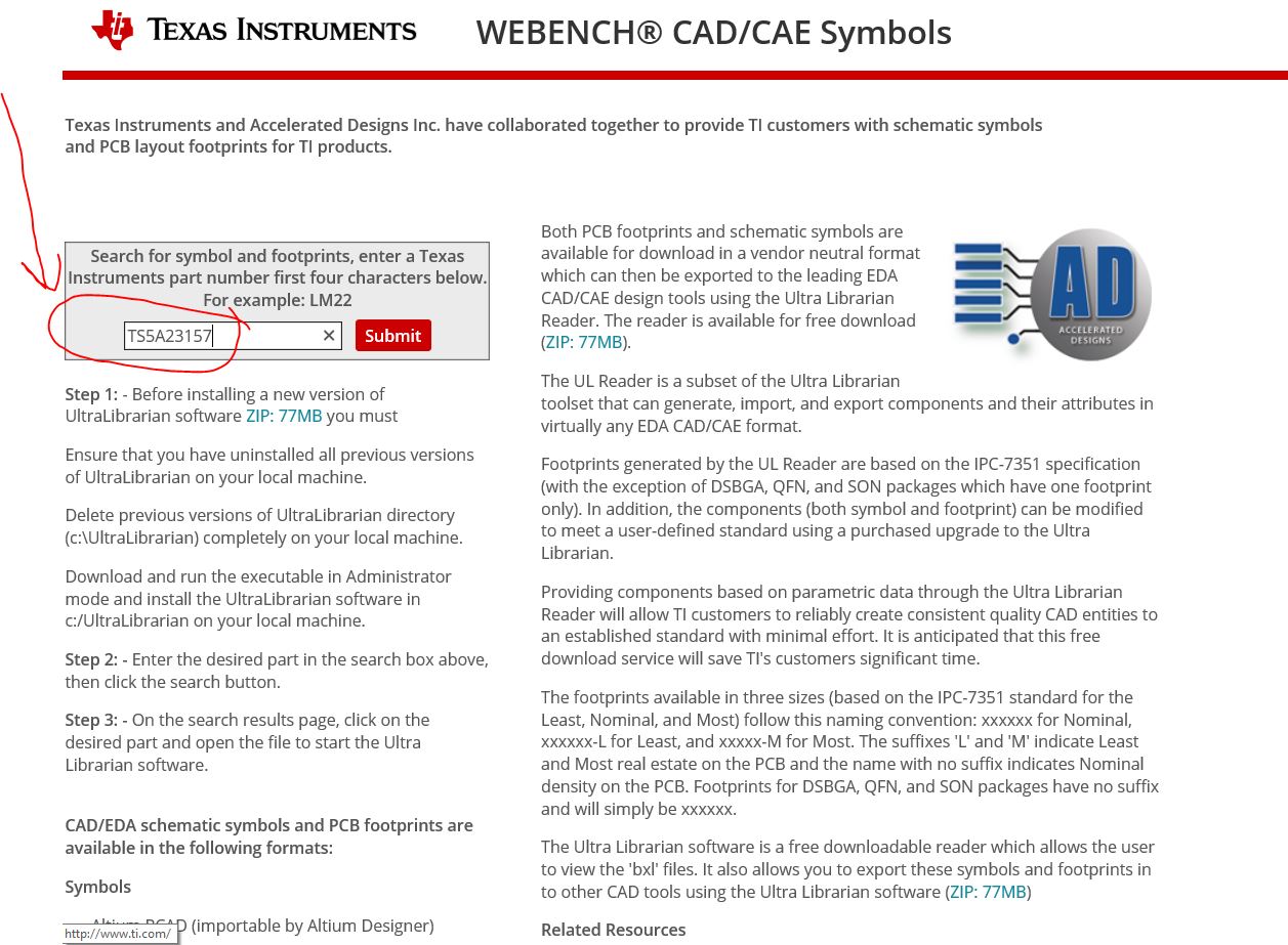

Next I typed in the part number "TS5A23157 into the search box.

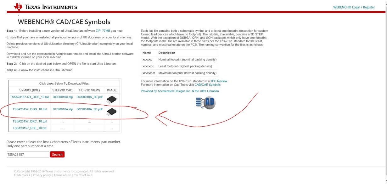

Which finally brought me to the TS5A23157DGS .stp file.
Let me know if this helped.
