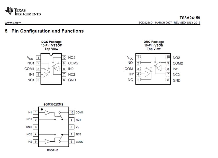

Hi, Do we have a p2p replacement to SGM3002XMS? The package required is MSOP10, and customer using it in analog audio signal switching.
Fery,
The TS3A24159 DGS is not p2p with the SGM3002XMS

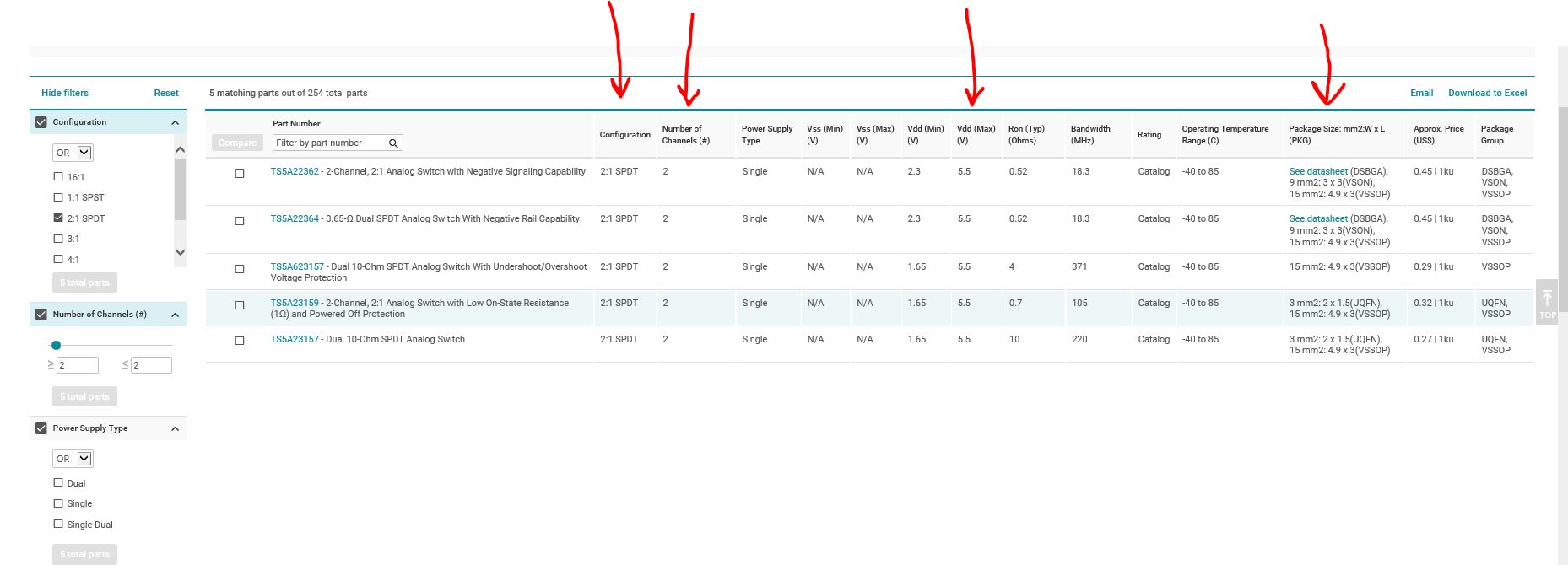

The SGM3002 is a 2-channel 2:1 device. You can use the TI.com switch selection tool to filter the >250 switches by configuration, channel count, package type and voltage supply.
These filters return 5 different parts and the TS5A23159 is p2p with SGM3002
