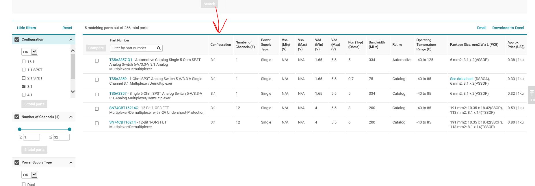

Hi Team,
I'm looking for a Mux capable of switching 3 stereo audio on 1 stereo audio output. So a 3:1 architecture with stereo input and output. Do we have something like this?
Simon
  • Simon,
    Please look at the Ti.com switch selection tool for TI's 3:1 switch offering.
    What is the voltage level of the signal you would like to support?  These switches support signals from 0 - 5.5V.
    Depending on your audio signals some are centered at 0 V which means you will need to select a switch that can support the negative swing.  Here is an e2e post showing some TI audio switches that support negative voltage signals.
    Thank you,
    Adam
