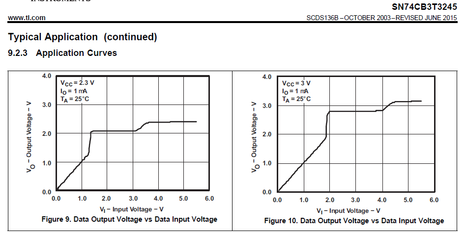

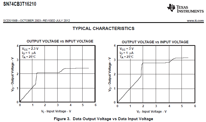

9.2.3 Application curves: I think the Io parameter is wrong: Io = 1 mA should be 1 uA...
Compare e g the corresponding diagram in scda008, 5.3.1.1 (figure 30); sn74cb3t3257 Figure 3; sn74cb3t16210 Figure 3
