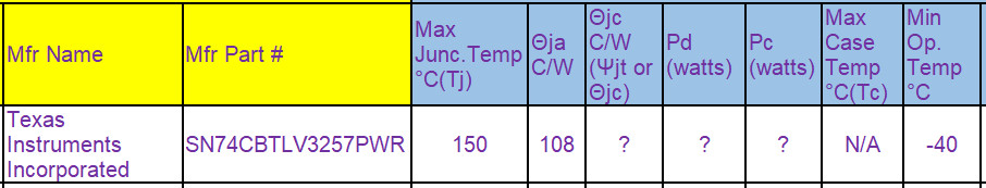

Hi Team,
Please help to confirm the Θjc, power consumption(Pc) and power dissipation(Pd) of SN74CBTLV3257PWR.

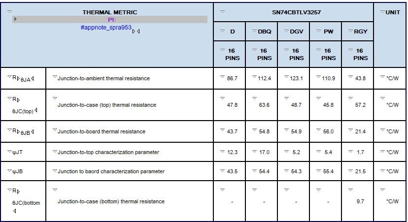

    Please see the thermal metrics below.

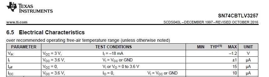

    The power consumption for the device can be found in the datasheet labeled Icc.
