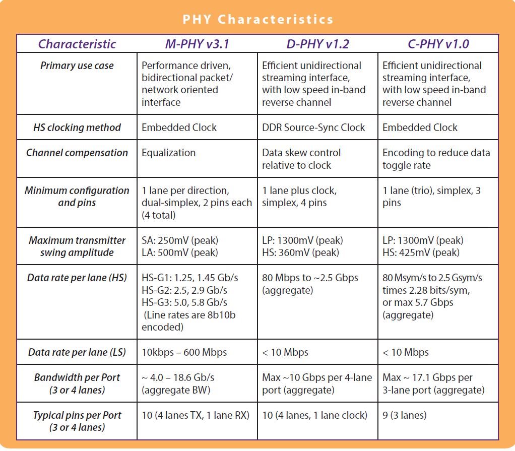

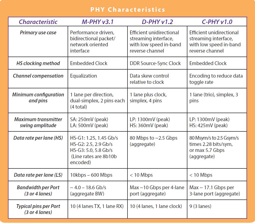

  • Dear Adam
    Based on the above table,"C-PHY v1.0","Data rate per lane(HS)",is up to 2.5Gsym/s, what is the "Gsym/s"?
  • Went,
    Gsym/s = Giga symbols per second
    The mipi standard describes the C-PHY encoding scheme to have symbols.  This presentation beginning on slide 6 shows more information.
    Please note this doesn't have anything to do with the TS5MP646 device since it is simply a passive FET switch.  You will need to work with the specific Mipi PHY you are using for more information on the symbols, encoding, and mapping.
    Thank you,
    Adam
  • Hi,Adam
          1.  I can't open the link of "slide 6",it's prompting invalid link.
          2. Based on the above table,"C-PHY v1.0","Data rate per lane(HS)",is up to 2.5Gsym/s, the lane has three cables?
          3. Based on the second question, data rate per lane can support up to 2.5*2.28=5.7Gbps ?
    Yes, the table above shows that D-PHY has 4 pins for data and the C-PHY has 3 pins for data
    Yes, the table above states D-PHY can support up to 2.5Gbps but the C-PHY includes a different encoding scheme and mapping to support more data per pit using symbols which leads to the calculation 2.5*2.28=5.7Gbps for C-PHY effective datarate per lane/pin.  You can see that the effective data per port in the table is the datarate per lane/pin times the number of lane/pins.

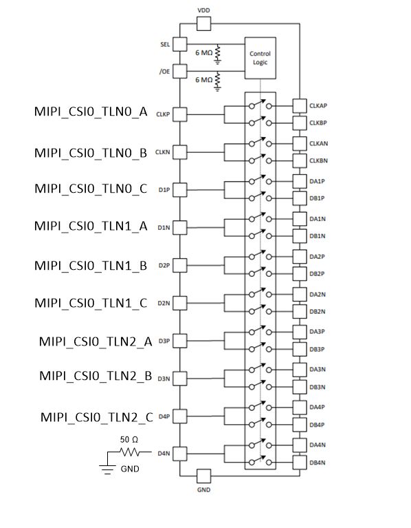

         4. I will use TS5MP646 device to connect C-PHY, please provide a complete circuit connection diagram, and the definition of TS5MP646 pins for the C-PHY definition.
    The TS5MP646 is a passive FET switch and it doesn't matter what type of signal is placed on the pin.  You can mix and match the pins how you need it for your most optimal layout.  If you can you provide me with a picture of the pinout of the Mipi PHY port pin names you would like to use and I will link them to the pins of the TS5MP646.

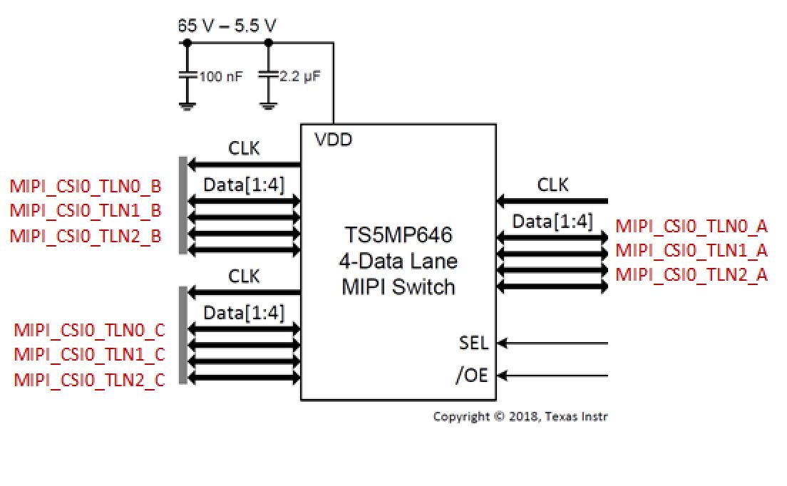

    Went: The C-PHY port pin is like this,could you link them to TS5MP646?

  • Hi,Adam
          My C-PHY  mode has three channels,and nine lines in total.Your designing is not fit to my C-PHY.
          I want to switch two C-PHY modes by TS5MP646 devices,could you share me detail design?
  • Went,
    Does this picture make it clear?  The signal path of the TS5MP646 doesn't care what signal goes into what pin they are all the same.
    If you have an used pin it is recommended to terminate it with 50 ohms to ground

  • Dear Adam
            Thank you very very much.
            I draw a connection diagram for two C-PHY modules with TS5MP646 device, please help me check it for right or wrong. Thanks.
  • Went,
    Your drawing looks reasonable to me.
