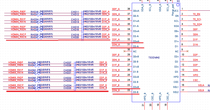

Hi Team,
According to datasheet, can we random choose any one of CLK diff signal input of HDMI ch A & ch B ? (as showing below)
Sorry, we don't get the right answer since the question would be not very clear.
The point is that customer just would like to confirm with you if HDMI's CLK differntial input can be connected to any channels of this device (Channel 0, Channel 1, Channel 2 or Channel 3) or not? Or is there any specific channel assigned to connect to CLK input of HDMI?
