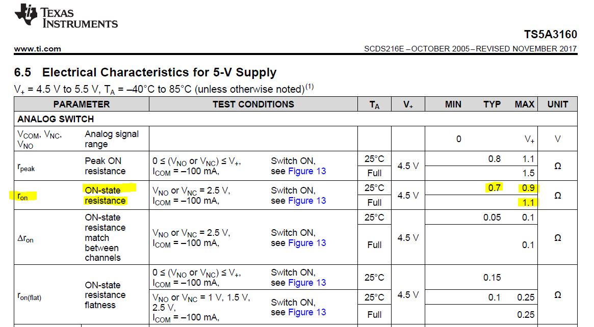

  • Sadan,
    The TS5A3160 device is specified to have about 1 ohm on state resistance with a Vcc =5 V .  The resistance is measured by sinking a known current (-100mA) through the switch, supplying a voltage on the input (2.5 V), and measuring the voltage drop on the output.  Then the Ron is calculated by (2.5 V-Vout)/-100mA

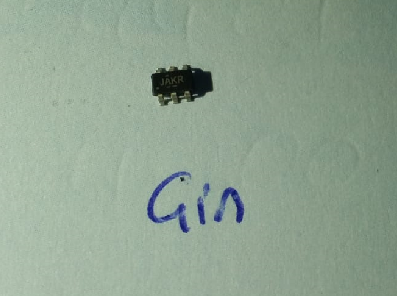

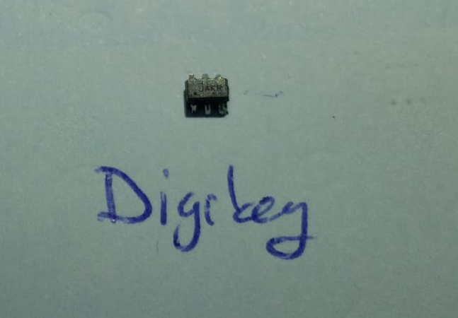

    Here you can see the top pictures of TS5A3160DBV we bought from Digikey and China. Both have "JAKR" marking on their top.
    I am triying to find any details about the orders. If i can find, i will inform you
    Sadan

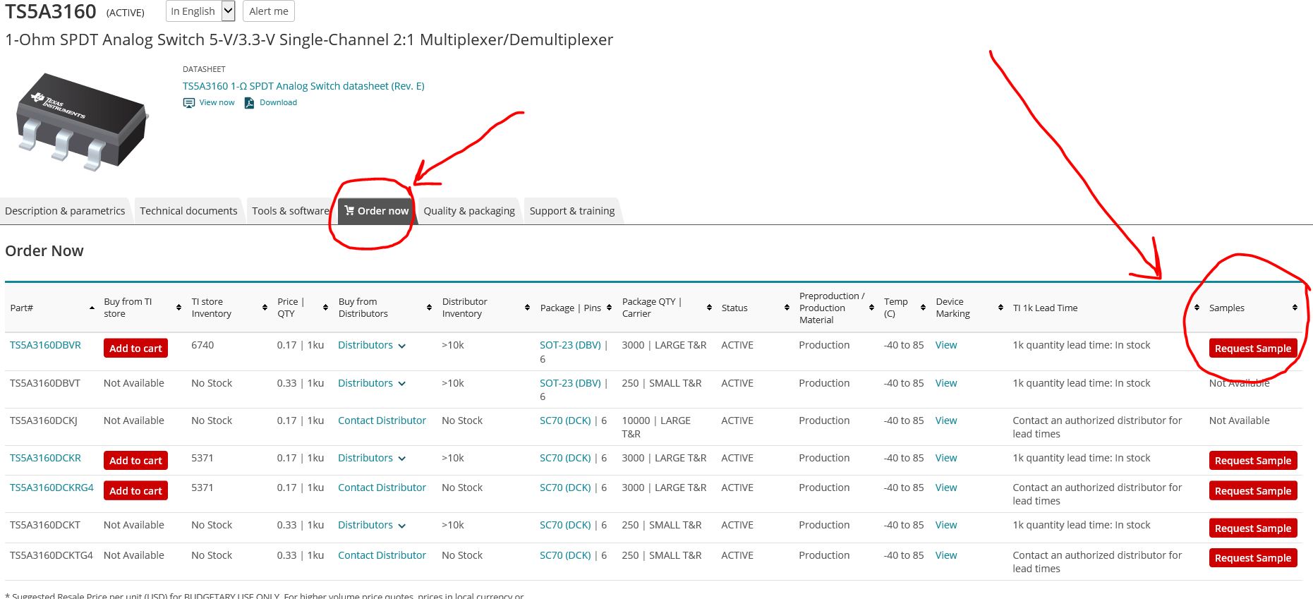

  • Sadan,
    How are you measuring the resistance of the most recent devices you received?  Do you have a diagram of your test procedure or scope shots of your results?
    You may order samples from ti.com by navigating to the TS5A3160 product page, select the order now tab, and request samples.
