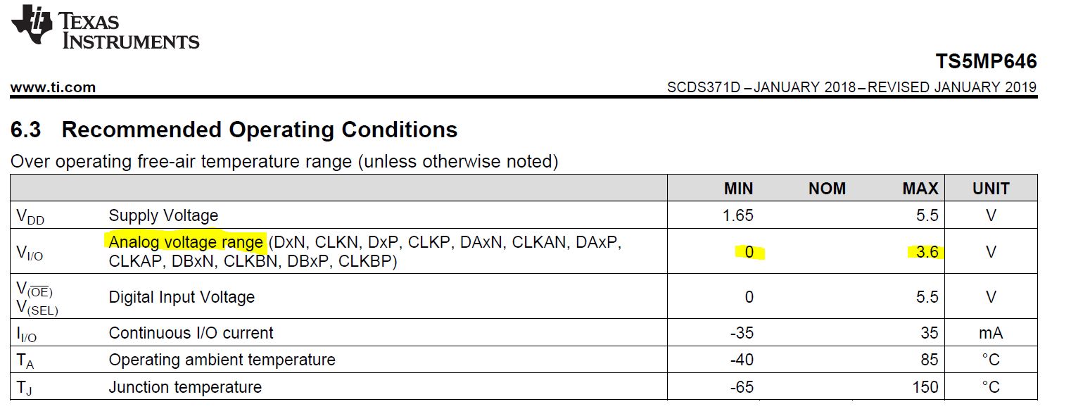

My customer wants to use TS5MP646 as a LVCMOS signal switch.
Can TS5MP646 support the conditions below?
  • 1.8V signal at 200 MHz
  • 3V signal at 100MHz
Power supply may be 1.8V or 3V.
Thank you.
  • Whitney,
    TI's passive FET switches like the TS5MP646 can pass any signal protocol as long as the voltage and bandwidth requirements are met.
    The TS5MP646 will support both 1.8V and 3.0 V signals as stated in the recommended operating conditions in the datasheet 0 to 3.6 V.
    The TS5MP646 will also support both 1.8V and 3.0V power supply as the recommended range is 1.65 V to 5.5 V seen above.
    The TS5MP646 device includes a charge pump on the gate of the signal path FET which means the voltages supported on the I/O do not have to depend on the Vcc voltage.  For example, with  Vcc = 1.65 V the TS5MP646 can pass signals up to 5.5 V on the I/O path.
    The TS5MP646 has 3 GHz bandwidth which is enough to cover your 100 and 200 MHz signals.
