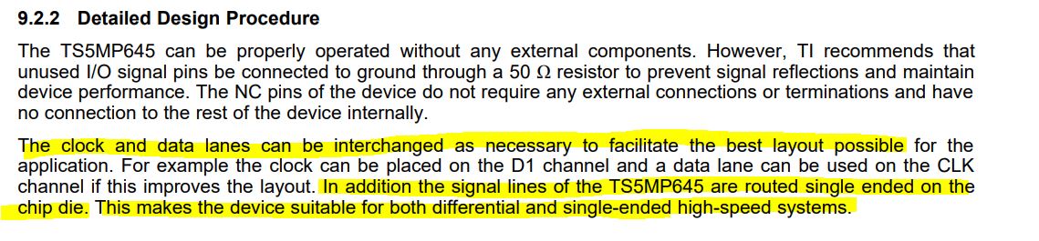

TS5MP645: whether support single-ended Clock input?
Part Number: TS5MP645
If supporting,how to deal with CLKN,CLKP?
CLKN connected to GND, CLKP connected to clock input?
