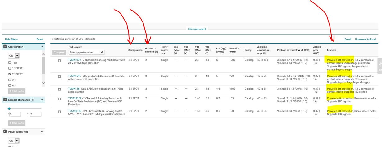

Hi Team
I have one question for TS5A23157.
My system on DC OFF mode. We have Voltage on pin 9 ( 2.5V )
and I did not provide VCC on Pin8
But I have measure voltage on pin 2(3.1V) / Pin 10(2.5V) / Pin8(2.4V)

Kerr,
I'm glad you found the answer to your question on e2e. Would you mind sharing the link to the post that helped you so other customers may be able to find the answer like you did.
It sounds like you might want a device with powered off protection which ensures the signal path is hi-Z even if Vcc = 0V.
