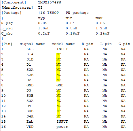

TMUX1574: TMUX1574 IBIS model question
Part Number: TMUX1574
customer reported the TMUX1574 model input nodes are NC.
ca n we check it and confirm it correct?
  • Peter,
    The signal path pins is a passive FET switch and not a buffer so it is not really valid for the signal path to be an input or an output buffer model.  The only bufferes in the IC are the control logic pins SEL and EN.  What are you trying to learn about the switch behavior?  We can probably teach the customer about the performance of the device in their application a different way.
