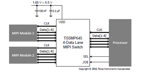

Hi team,
According to below figure, input data is fixed by processor and we can select which Mipi module we use. but our customer wants to realize that input data is selectable and output data is fixed. It is like opposite way. Is it impossible to use such a way? if impossible, do you have any other recommendation devices?

  • Hi Adam,
    Thank you for your reply. I understood the TS5M645 was also be able to use bi directional. but how do we check that the switch can use bidirectional by the datasheet?  Our customer wants to get an evidence.
    Masayuki
  • Masayuki,
    You can see in the diagram you attached that the arrows point both directions which indicates signals can go in either direction.
    Also you can see that there aren't any Voh or Vol specs in the electrical specifications table showing that there is not a buffered output.
    This is a passive FET switch and either the drain or the source can be the input or output.

  • Hi Adam,
    Our customer thinks that the CLK direction and DATA direction should be same if they use CSI-2. According to the pin function of the datasheet,  any clock pin is differential I/O. That's why I'll explain it to customer that the device can use both directions. Is it correct in my understanding?
    In addition, do you have any plan to make an automotive version for TS6MP645?
    Masayuki
  • Masayuki,
    You are correct that any pin of the TS5MP646 can be used for either clock signal or data signal. The device doesn't have any intelligence built in or any drive capability. You can think of this device as a wire with some loss.
