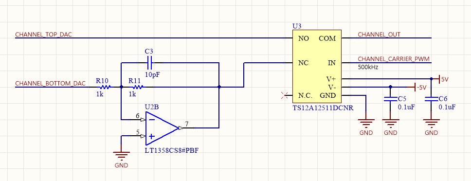

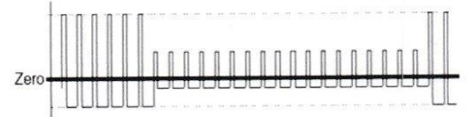

I need to modulate the analog signal from -2.5V to + 2.5V with PWM 500kHz
Now I use TS12A12511 and DAC, but TS12A12511 is very noisy from the carrier frequency. This becomes very noticeable when I modulate voltages around 100mV.
My question is how can I still solve this problem?
Perhaps I need a completely different approach?
