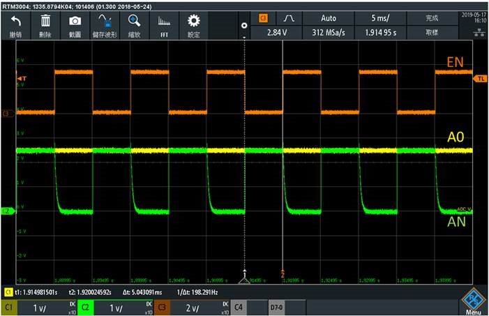

  1. below graph was testing EN (pin6) at 5ms condition
S0 & S1 were fixed at LOW
Output AN depends on EN LOW (on) ,HIGH (off)

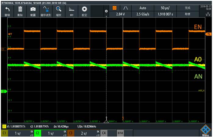

2. Below graph was testing EN at 50us condition
As we see, Output AN show abnormal waveform, seems EN toggling being too fast.

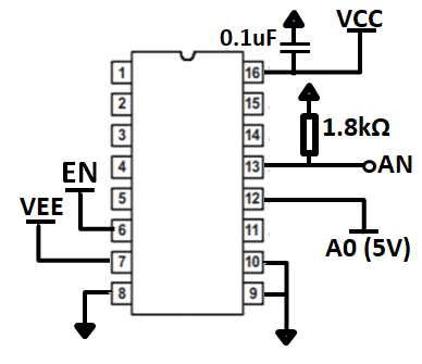

  • Andrew,

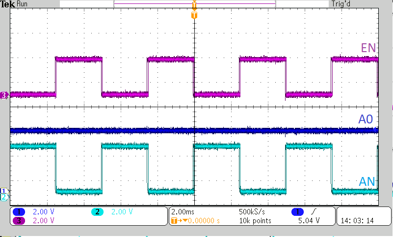

    After running tests in the lab with the similar setup on the toggling speed we found that the switch was able to perform properly toggling the enable at 50us with the circuit layout shown below. I tested an order of magnitude quicker as well (5us) and it looked fine. All the waveforms are also shown below.
    1.
    The graph below shows tests under the same test conditions as your initial case:
    EN pin at 5ms
    S0 & S1 low
    Power Supply 3.3V
    1.8k Ohm pull down, 5ms Period
    Here we found similar results, with the offset present. By changing the pull down resistor at the output (AN) to 200Ohm the offset was minimized. It’s not recommended to pull down with a lower resistor as the current draw begins to increase with lower resistance. The results are shown on the next graph:
    200OHm pull down resistor @ AN , 5ms Period
    2. When decreasing the switching time with the same circuit shown above with the 1.8k resistor on AN and a switching time of 50us the below graph was the result:
    EN pin toggling at 50us
    S0 & S1 low
    1.8k ohm pull down @ AN, 50us
    3. This toggling period can be decreased a bit more with the same 1.8kohm pull down at output and see decent results. I ran the speed down to 5us with the same circuit above and saw the following:
    At higher frequencies you will need to adjust the circuit to see better results.
