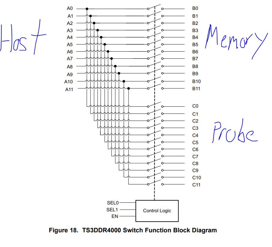

I have planned to use TS3DDR4000 - TS3DDR4000 12-bits 1:2 high speed DDR2/DDR3/DDR4 switch/multiplexer is my design.
My requirement is to tap the DDR4 address and command lines.
So i am planned to connect Address and Command lines from Host to input B and connect address and command lines from memory to input A. I will short B and C internally in PCB and take output C for my probing purpose will this design topology works. Or do you have any other suggestion for taping high speed lines for probing.
  • Rohith,

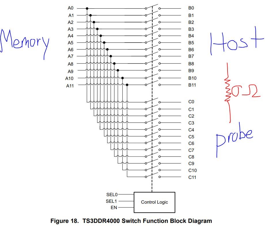

    Let me see if I understand correctly.  You would like to isolate the memory from the host during probing of the host signal?  If you short host to probe there will always bee a stub on the line.
    You may want to consider connecting the host to A, the probe to B, and the memory to C.  This way you can have the host communicate to the memory without the probe stub.

  • Dear Allen,
    My requirement is not to isolate Host from memory while probing, I want to connect Host Memory and Probe in single point without stub.
    Do you have any design topology for this requirement.

  • Rohith,
    I don't have a design topology to probe a signal path without a stub.  I'm sure you can physically do this because there will always be a stub but some stubs maybe lager than others.  There will still be a stub inside the IC but not on the same scale as a PCB trace.

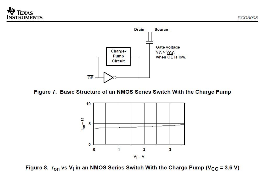

    What performance are you trying to simulate?  An I/O Buffer Information Specification (IBIS) model is not valid for this type of passive device (no buffer).  There are s-parameter models in this e2e post below or SPICE model on the TI.com product page.
    The signal path is an NFET with it's gate biased by a charge pump.

  • not sure what you want to do. It either goes from A to B or A to C. if you short B and C, then you don't need this switch.
