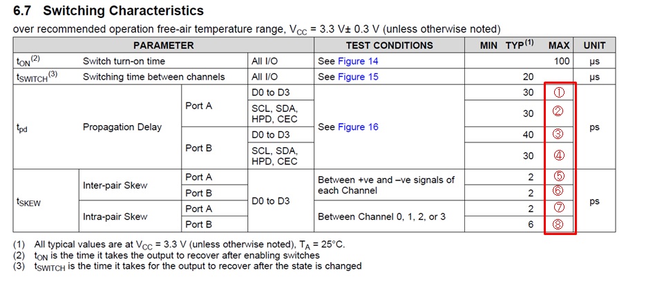

Hello team,
My customer would like to know the Maximum of Propagation Delay and Skew as the following (1) - (8).
Would you please provide with the maximum data to design products as the reference?  We do not need the guarantee against the value that we answer.
 Your advise would be so appreciated.
