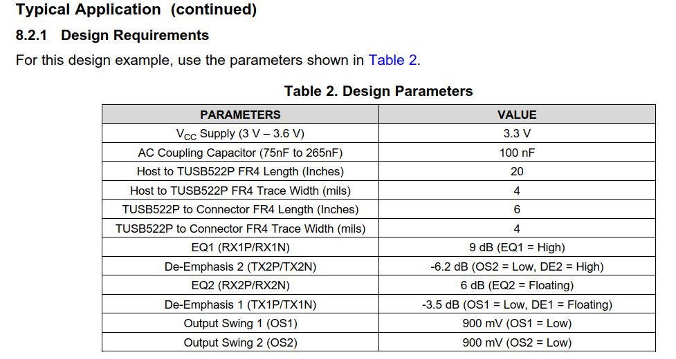

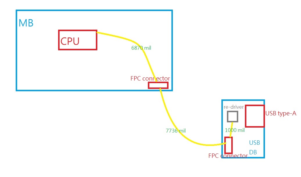

In our design, USB3 Gen1 total length is about 17.5 inch included one FPC cable(7736mil) & 2 FPC connector.
Would you suggest us use TUSB1002A or TUSB522P to meet the long trace in this application?
