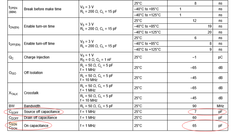

Hi TI,
What do you mean by TMUX1108 CSON/CSOFF?Where is the capacitance value tested?thank you
Hi Wang,
The On and Off capacitance is how much capacitance the signal line has with respect to ground. This is tested on the source and drain (input/output) pins.
Please refer to these other E2E posts on this subject.
TMUX6111: Source off-capacitance - Switches & multiplexers forum - Switches & multiplexers - TI E2E support...
TMUX1208: Input Capacitance on Signal Lines - Switches & multiplexers forum - Switches & multiplexers...
