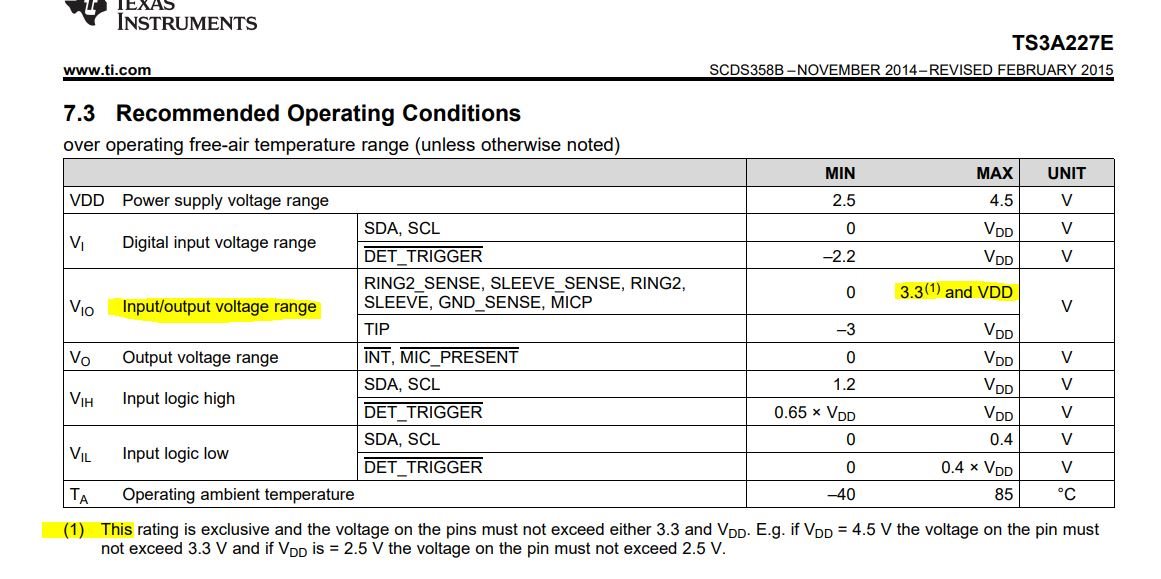

Also, we are using a codec CS42L51 which receives 2.5V VDD, and can output a maximum of 0.8*VDD=2V. In the datasheet, the range that the device expects starts from 2.1V. Is it possible to operate the device with 2V as the bias voltage?

    The recommended operating conditions state that you can have a voltage between 0 and VDD.

    Regarding the MICBIAS voltage, I understand that applying 2V won't harm the device, but will the key press detection work? Since I can only set the expected MICBIAS voltage to 2.1 or more.

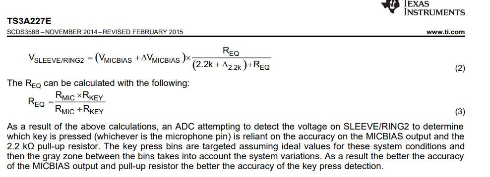

    Detailed information on the key press detection can be found on beginning on page 41 of the datasheet.  This will show you the formula you can use to calculate the voltage on sleeve/ring2 and the equivalent resistance detected by the device.  You can see that the mic bias voltage value can be different voltages but it is important that what ever voltage it is in constant.  The important part of the equation is the change in mic bias voltage when the key is pressed introducing a parallel resistor.

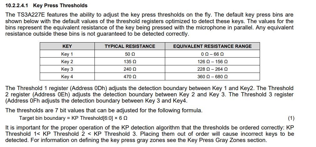

    You can also adjust the resistance bins that the TS3A227E can detect to further tune your system.

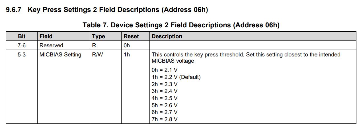

    I am specifically concerned that if I use a 2V voltage, it would be a problem in terms of key press threshold voltage, otherwise why would I need to choose the MICBIAS setting as in the attached table from the datasheet?

    The description states set this setting closest to the intended micbias voltage.  If you intend micbias to be 2V then 0x0h would be your closest setting.  This sets the micbias voltage in the equation above and then the device measures the voltage during the key press to calculate the delta mic bias voltage.
