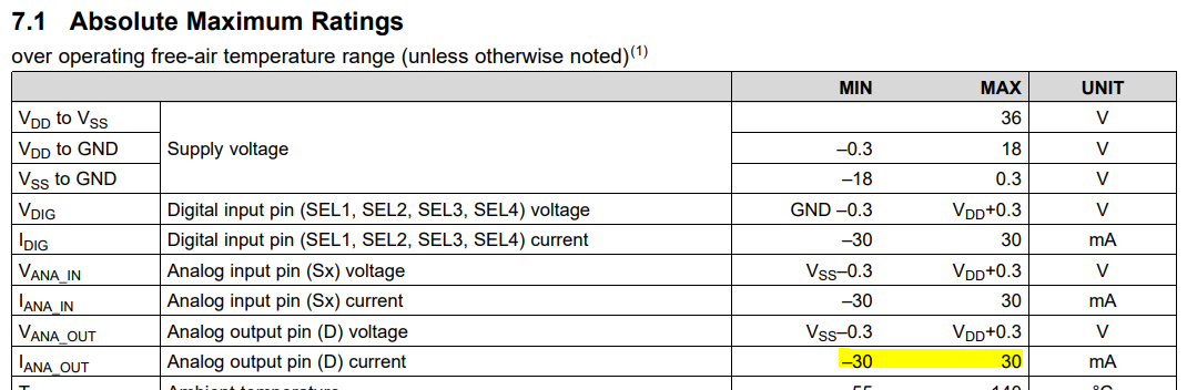

hello, What's the highest output currnet (load current) of TMUX6111 ? couid it be as high as 100mA ? or does TI have any SPST chips support 100mA output meanwhile with 2 or 4 channels ?
The highest current to be carried by TMUX6111 is 30mA as shown in the Abs. max table. To pass higher current, we would recommend using one of TI's load switch devices.
