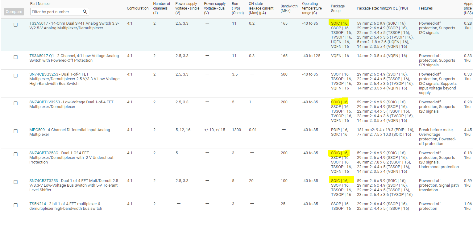

Hello David,
can you suggest a device that has similar footprint to CD4052 & supports powered-off protection.
Regards, Holger

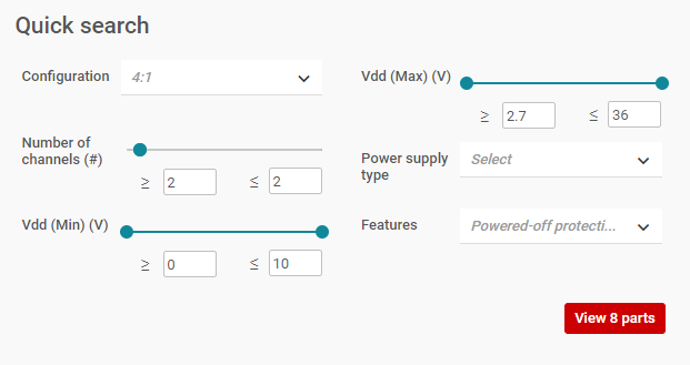

Hi, Holger,
Which package are you looking for specifically? The CD4052B is offered in DIP, SOIC, TSSOP, and SOP packages.
You can find a list of devices that support powered-off protection by filtering the feature in the parametric search tool on TI.com. There are currently 8 devices in differential 4:1 configuration supporting the powered-off protection feature.
