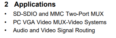

Hi team,
For example, can TS3A27518E be allowed to use a dual host that switches two processors to one SD card?
I think this is ok, because it is a bi-directional device.
However, since similar product of other company is listed as dual-host compatible in the data sheet, I would like to confirm that the TS3E27518E can also be used in dual-host.
Tomoaki Yoshida
  • Hi Yoshida-san,
    Yes, the TS3A27518E can be used for switching two processors to one SD card.
    As long as you keep the system within the recommended operating conditions the application does not really matter since this is a bidirectional switch.
    Here is a note from the datasheet to help support the customers need.
