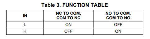

  3. In the Table3.FUNCTION TABLE of the data sheet, OFF means high impedance or complete open?

    The typical impedance of all our switches is very high (in the range of Giga Ohm) -  The functional table "OFF" refers to very high impedance. You cannot pass  any signal as the circuit is open.
