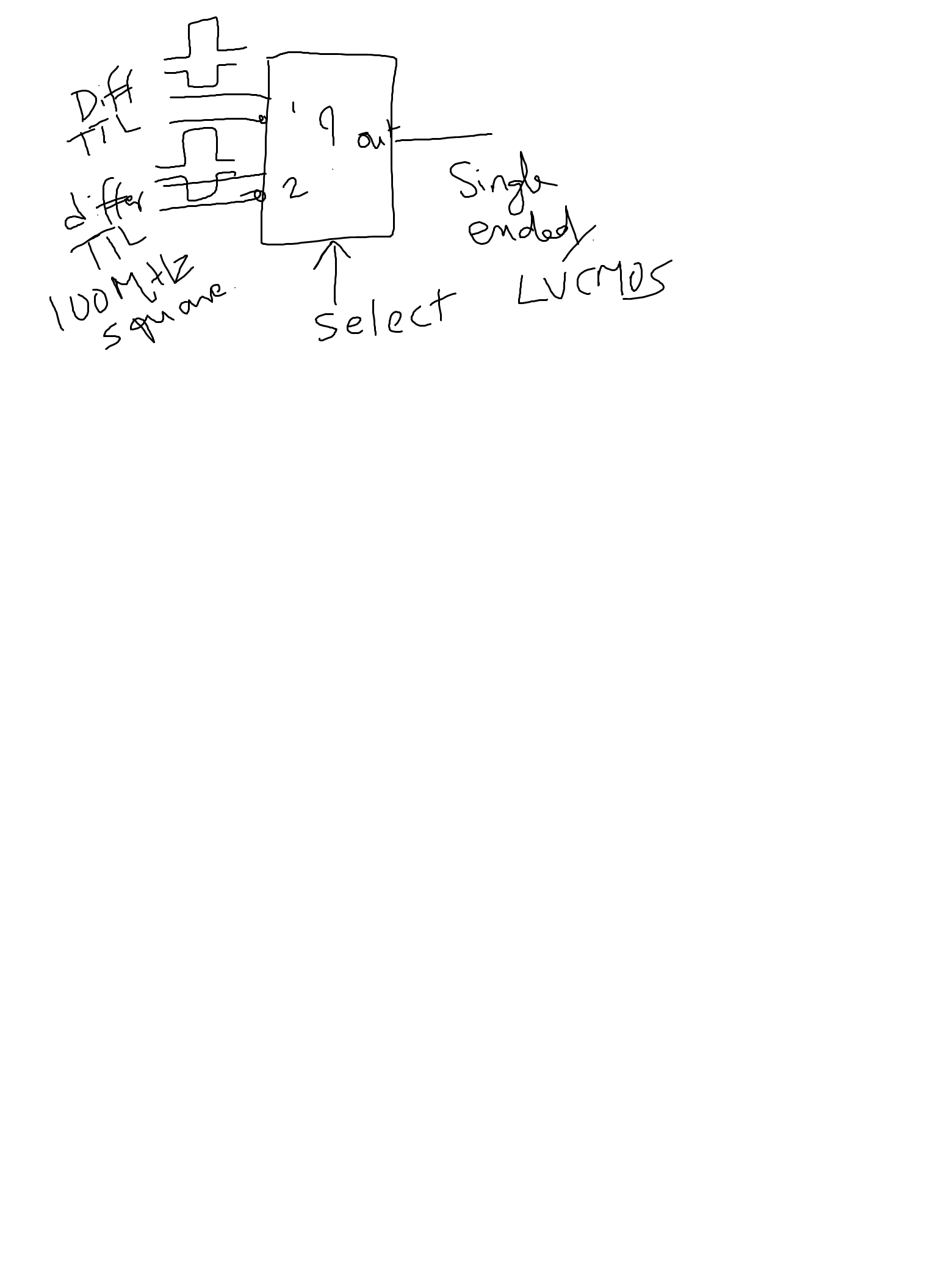

Do you have any 2:1 differential mux which gives output as single ended.
Input signal frequency is 100MHz Square wave
Rise time of signal is less than 1ns.
Output shall be of LVCMOS or any other technology.

We do not have logic devices that support differential inputs. However can you use only one of the differential pair inputs on a single input logic device?

Can you explain more on what you mean by the rise time? Are you referring to tON, tOFF, tswitch or propagation delay?
We have TMUX1136 - 2:1 , 2-Channel Precision Switches that has 250 MHz bandwidth.
Here is the link to our 2- Channel Switches (differential mux which gives output as single ended). Take a look at these switches and let me know if this is something you can use in your application.
