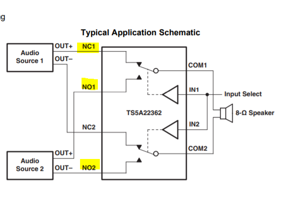

Can TS5A22362YZPR input audio source be one for SE(OUTR+), another for Differential(OUTR+ OUTR-)?
Thanks, Ian.
  • Hi Ian,
    Yes, If you look at the block diagram for TS5A22362, you could use NC1 for SE and NO1 and NO2 as differential inputs. (Put NC2 to ground)
    It is a good practice to ground unused input pins in the SE use case to avoid any undesirable signal reflections.
