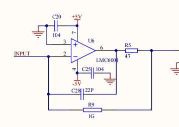

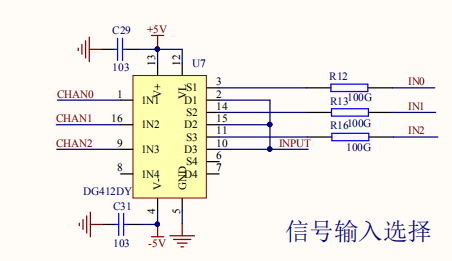

I am using the TMUX6111 as a current channel switch, usually a current signal of pA level or lower. The actual test found that when one channel was measured, the other two channels also had similar measured values. The following is my application circuit, and now has the following questions: 1. Is the current too small to be applicable? 2. If there is no problem with the current, what is the cause of the crosstalk of the switch? How to solve 3, what better application method?
