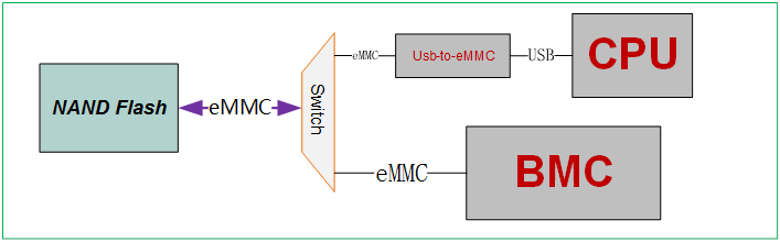

do we have some solutions can be the eMMC switch here. Thanks.
Hi Frank,
Many of the eMMC have 6 signals 4 data bits, a clock, and a command line. If these are the 6 signals you are looking to switch,then the TS3A27518E is a good option (depending on the bandwidth of the switch matches what your end application will be)
