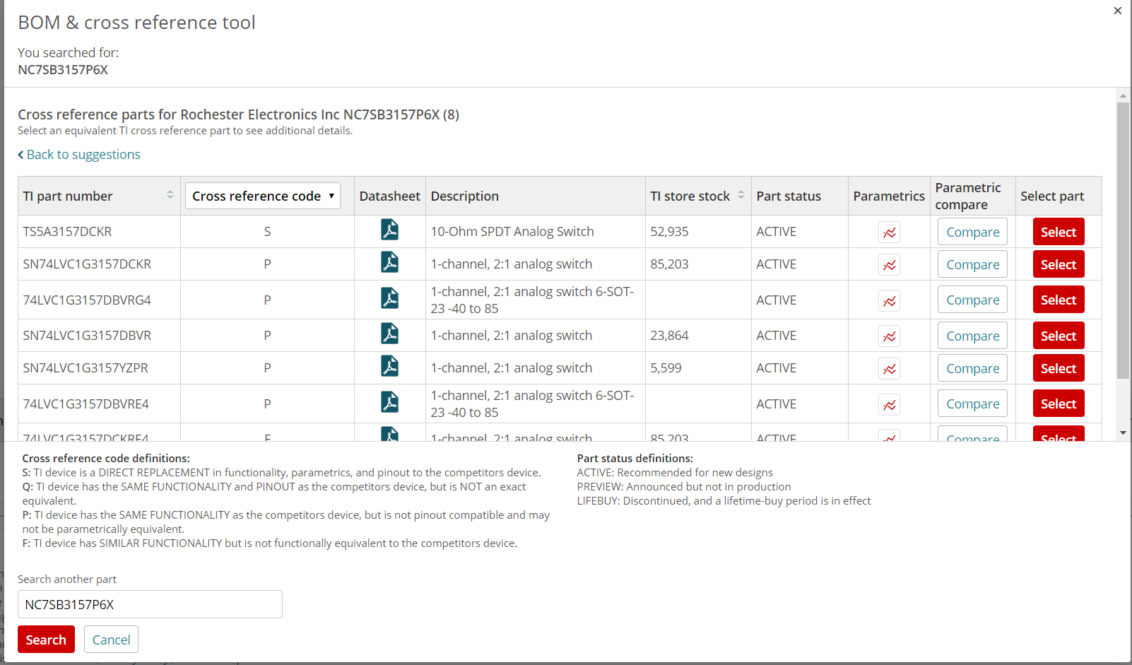

I am looking for the best TI replacement to the NC7SB3157P6X switch.
https://www.onsemi.com/pub/Collateral/NC7SB3157-D.PDF
What is our best device to put on the table for this opportunity with most similar specs?

Hi Kate,
We have a cross reference tool on ti.com (link) where you can enter a part numbers to view equivalent TI cross reference part information, TI datasheets, instant inventory, and price data for each part number.
When I searched for NC7SB3157P6X, the following equivalent TI active cross references showed up (link):
Out of the parts showing up in cross reference tool, the SN74LVC1G3157DCKR.is the best recommendation. This device is p2p and is a great performance match (most competitors in this space have the same specs).
Saminah
