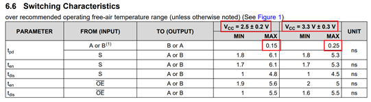

Looking over the DS for SN74CBTLV3257, I noticed that the tpd is *higher* at a higher VCC.
Why would the tpd be higher with a higher VCC voltage? Shouldn't it be lower?

Hi Peter,
Thank you for using e2e.
The propagation delay is the time between the specified reference points on the input and output voltage waveforms, with the output changing from one defined level (high or low) to the other defined level (tpd = tPHL or tPLH).
For the SN74CBT parts, the propagation delay Is measured from 50% of the rising edge of the input signal to 50% of the rising edge of the output signal.
As you increase Vcc, the 50% voltage level is also higher compared to at lower Vcc, and therefore you see a slightly higher propagation delay.
