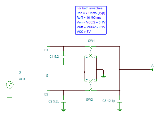

However, see below an approximation of the model (TINA file attached).

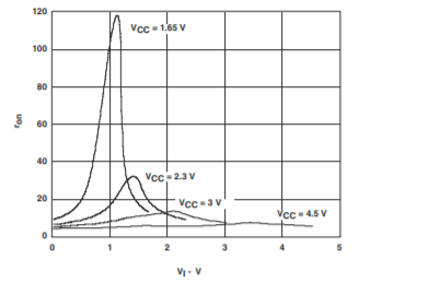

The datasheet graph also provides some details on the typical ron as a Function of Input Voltage (VI ) for VI = 0 to VCC

The TINA file I attached is the best approximation of the SN74LVC1G3157 model.
You can also take a look at another LVC part that has Pspice model available.
