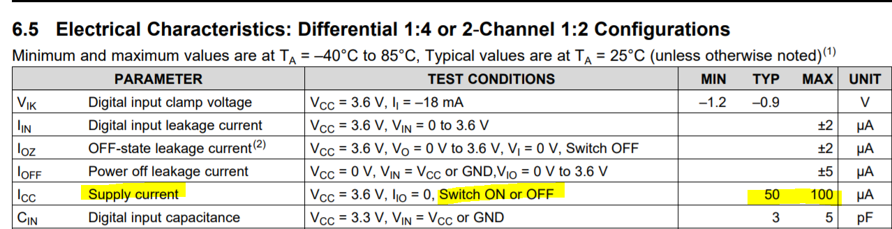

Hi team,
As title, is there a way to reduce power consumption of the device excepting turning off VCC? i.e. Can power consumption be lower if ENx pulls low?if so, how much? Thanks!

Hi Leroy,
The spec for positive supply current in the datasheet takes into account the switch being both on and off (Enx is low), with typ value of 50uA, when Vcc =3.6V.
What is your application scenario? Based on that, we can give you some good recommendations for switches with lower power consumption.
