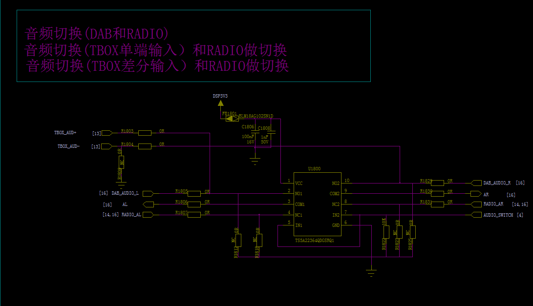

Is there a typical application schematic for TS5A22364-Q1? Now the customer is using a single power supply of 3.3V, and the input is a single-ended signal and a differential signal. Is there a schematic diagram for reference?
The figure below is the actual schematic diagram of the customer. Is it reasonable? Thanks.

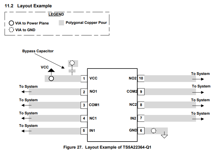

    We only have the Layout example in the datasheet:
    But I have checked your schematic and I saw a couple things:
    The Resistors R1800, R1812, R1818, R1822 and R1825 seem to be shorting the lines to ground? Or are they "Do not populate"?
    Otherwise the schematic looks good.
