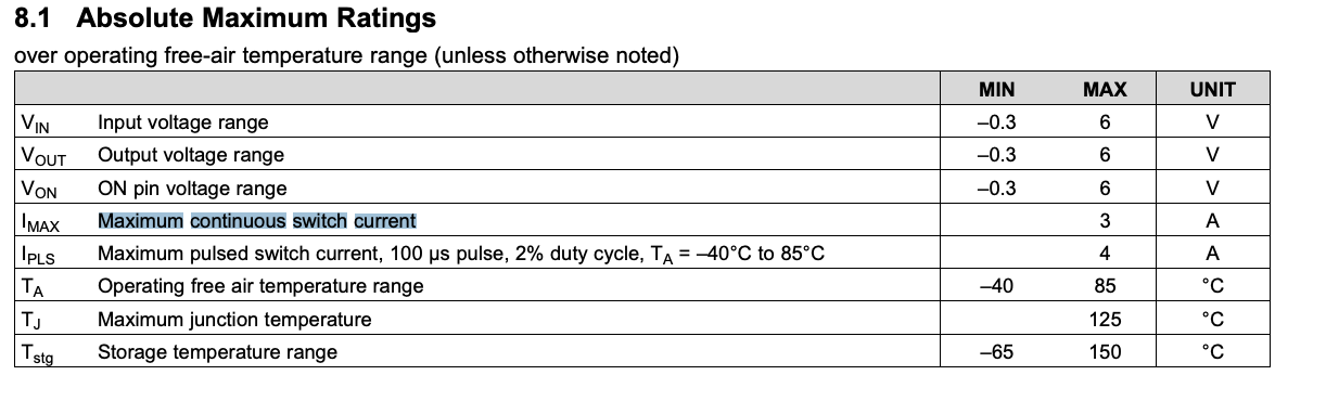

    Thanks for your reply. That is very helpful. I want to make sure that a part (e.g., TPS22963C: reverse current protection when disabled) have the same low Ron for either Vin>Vout or Vin<Vout. So that I will be able to run any value of continuous current from -3A to +3A. I'm a little worried because only max current of 3A is listed.
    Thank you very much,
    Yixin
  • Hi Yixin,
    Since this device does not have reverse current blocking when enabled (ON), the Ron is the same for bidirectional current.
    When OFF, reverse current flow will be blocked.
