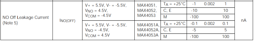

My customer wants to know the typical and maximum OFF Channel Leakage Current when VDD=5V and 3.3V, TA=25C and ALL, and our datasheet only claim VDD=18V. Customer need lower leakage current and MAX4051A claim +/-0.1 nA max, can our device leakage current support this range? Thanks.

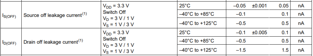

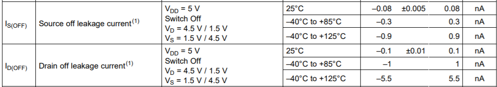

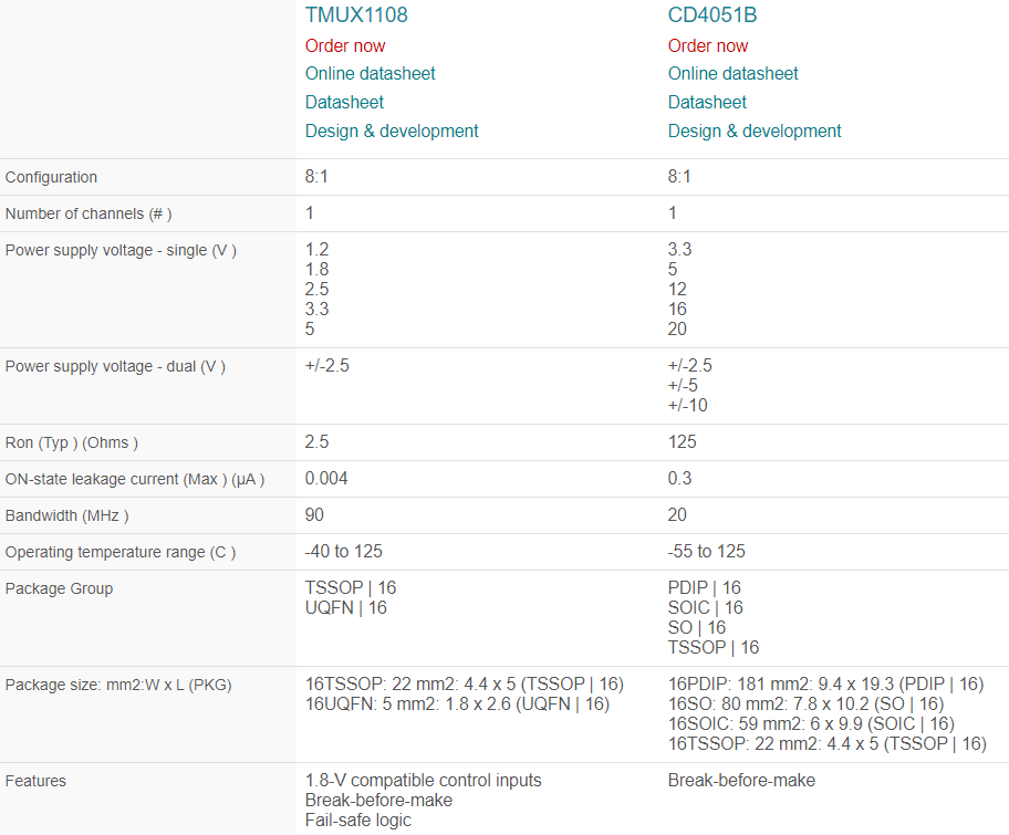

    If they are using the device at VDD = 5V or 3.3V, I would like to suggest using TMUX1108 instead. TMUX1108 is a low-voltage device with lower leakage current, 1.8V compatible logic inputs, fail-safe logic, and break-before-make delay. Take a look at the OFF leakage current characteristics at VDD = 5V and VDD = 3.3V below:
    Let me know what you think about TMUX1108.

    In the meantime, could you let me know the customer's application/end equipment? Even though the customer has used CD4051B before, I highly recommend suggesting to replace with TMUX1108 (instead of the MAX device). As I mentioned earlier, TMUX1108 has excellent, low leakage current and performs well at the voltages your customer is using. TMUX1108 has significantly lower Ron as well as 1.8V logic compatibility and fail-safe logic.

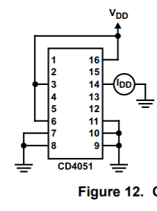

    I appreciate your patience for this measurement.
    According to our measurements (setup diagram shown below), off leakage current for CD4051B at these voltage levels, 5V and 3.3V, should be less than 10 pA. This should be suitable for your application of measuring resistance.

    Thanks for pointing out my typo. At 5V and 3.3V, you should expect OFF leakage current to be less than 10pA.
