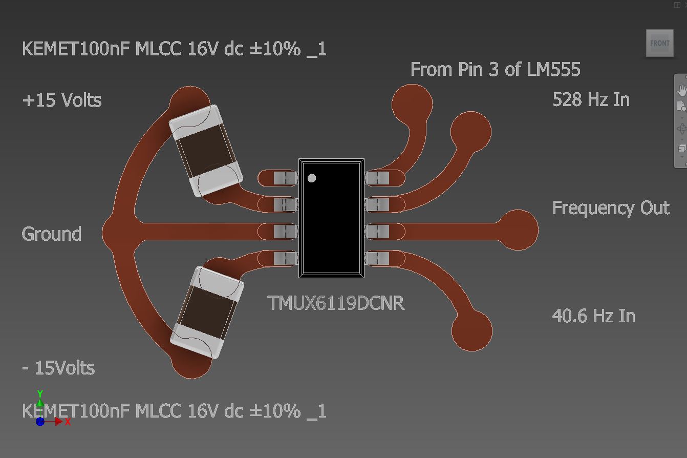

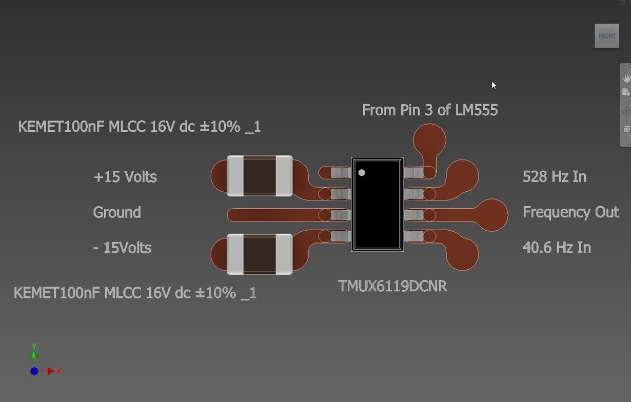

Ronald Michallick very kindly provided analysis and the following information appended below regarding a part of my circuit involving a LM555 timer to provide a high and low frequency pulse to a TMUX6119 switch.
But he has now confounded me by saying:
"The new board layout looks proper. Start a new thread with TMUX6119 as the part number and ask them if LM555 output is good for select pin.
Someone else will answer. Almost all questions with LM555 (as the part number) will be answered just by me."
Is it thus possible for the circuit that I have appended below to be checked for correctness please?
Finally the curved layout style is unique to us as an organisation. In time as our work is made public, you will understand the need for our method. In short, we are not just interested in the flow of electricity, but in the flow of Bioenergy and thus our circuits are designed more akin to how nature would have them.
I would be most grateful to anyone whom can accurately assess my layout please as advised by Ronald.
Thank you so much.
Christopher J James
Christopher,
No interconnects needed. Just connect pin 3 to the select pin on the analogue switch IC. Ground goes to ground. VCC+ can use same positive supply that the analogue switch uses.
The data sheet suggests adding bypass capacitance to power pin (+15V)
0.1 uF bypass ceramic capacitor
1 uF electrolytic bypass capacitor
Using equations in the data sheet , here are the results.
The TMUX needs a VIL less than 0.8V , the LM555 can meet that need.
The TMUX needs a VIH greater than 2V, the LM555 can meet that need.
I have said this multiples times, but I will say it again. LM555 pin 3 can connect to the TMUX directly without any other components.
LM555 low output will be near 0V. This level is valid (less than 0.8V). LM555 high output will be roughly 14V. This level is valid (greater than 2V, but less than or equal to VCC, 15V).
The data sheet suggest adding bypass capacitance to power pin (+15V)
