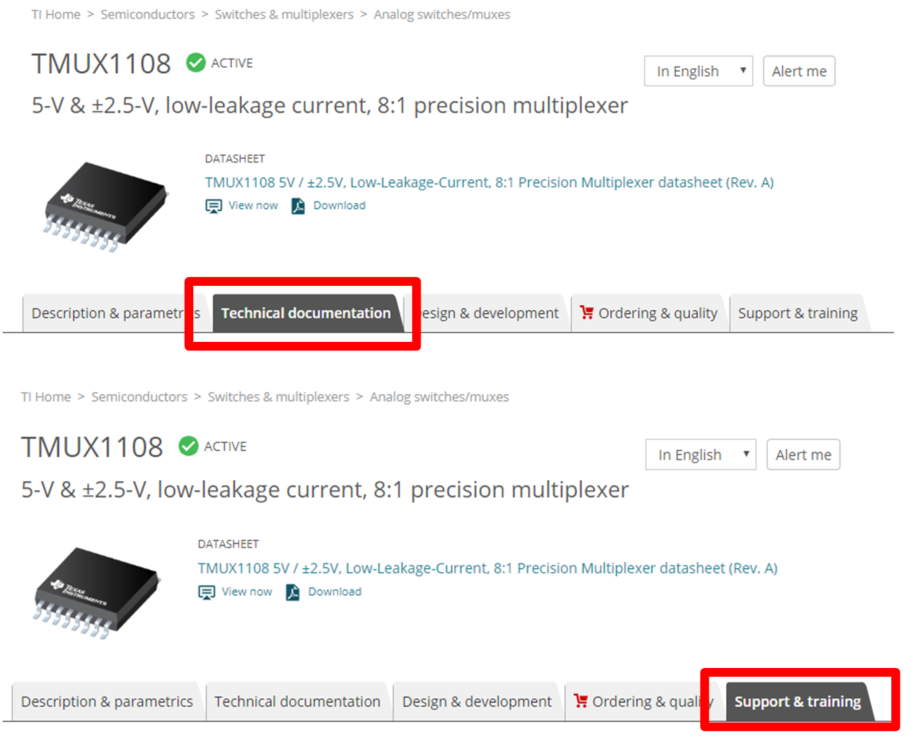

    This sounds like a great opportunity to implement the TMUX1108 mux for your measurement application, due to low Ron, low leakage current, and the 8:1 configuration. I do not see an issue with high impedance resistors.
    Online collateral related to specific devices can be found in the device product folder, in the Technical Documentation and Support & Training tabs, as shown:
    This will lead you to app notes, articles, relevant E2E posts, and videos.
