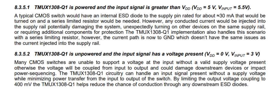

There is a period (approximately 1.5ms) when the voltage applied to the S1 and S2 pins exceeds the supply power(Vcc) at that timing.
I mean following condition might be existd in their circuit at start up timing and my customer concerns device gets a damage in this condition.
Vi> Vcc + 0.5V
Iin = 0.6mA * Vi current is about 0.6mA in customer's circuit and is limited by resistance.
So, I have been asked from the customer if this condition is acceptable or not.
Then, I look at the data sheet, I can find the following spec.
I understand as following from the spec though, Could you review if my understanding is correct or not?
The S1 and S2 Pins have protection diodes against ESD event but the internal diode will not be destroyed if its current is limited by less than ± 20mA.
Therefore, this IC will not be destroyed in the condition.
Takashi Onawa
  • A series resistor is indeed an acceptable mechanism to limit the diode current; the device will not be damaged.
    Please note that the 0.6 mA current flows from the S1/S2 pins into VCC and might power up the device.
  • Hi Takashi,
    Clemens is right about limiting the diode current to prevent the device getting damaged.
    I would also recommend looking at the TMUX1308 in similar configuration that offers protection which does not allow current to flow into VDD. It also supports additional features like 1.8-V compatible control inputs, Break-before-make, Current injection control.
