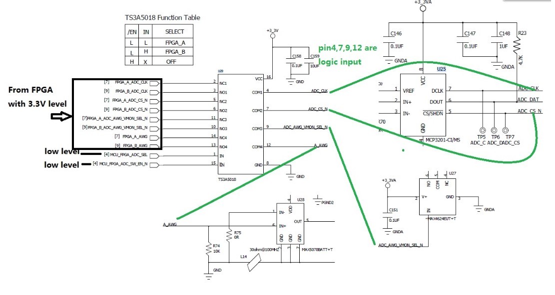

TS3A5018: we have got TI failure report, it indicates EIPD on wedge pad, we need your help to explain which kind of conditions will lead to EIPD of wedge pad damages?
Part Number: TS3A5018
I have the same issue with Xiaojian, we have 2pcs fail TS3A5018, after TI Failure analysis, it indicates the EIPD on wedge pad, would you please help us to check :
1) which kind of conditions will lead to an EIPD of wedge pad?
2) can you please help to check whether there is issue with our application?QEM-CCR-2002-00903 FA report.pdf

    Based on evidence obtained from failure analysis, Electrically Induced Physical Damage (EIPD) is the most likely cause of the issue. Based on the characteristics of this issue, a manufacturing non-conformance is judged to be unlikely. Therefore, it appears probable that the customer reported issue was caused by EIPD in the application environment, and TI recommends that the customer evaluate the application environment for sources of transient or steady-state Electrical Overstress. Detailed analysis and measurement of the customer’s board environment and the customer’s test environment will be required to identify the specific cause of EIPD.
    EIPD may occur during assembly or testing or may be a result of system design or specification violations, as shown below:
    While there is no apparent issue in your schematic, it is important to closely follow the below guidelines to prevent EIPD in your application.
