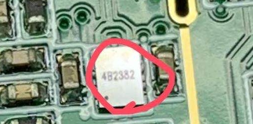

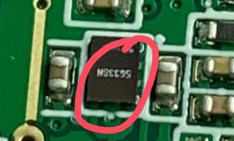

The screen printing on TS5A22364YZPR sample is "4B2382", and the screen printing on the normal batch order is" 56338N ", what is the reason?Is it the same IC?
 sample is "4B2382"
    Both of these markings are valid.
    "38” is the portion of the topside marking that represents the specific device. The other characters provide lot traceability information, and will vary accordingly. “_ _ _ 3 8 _”
