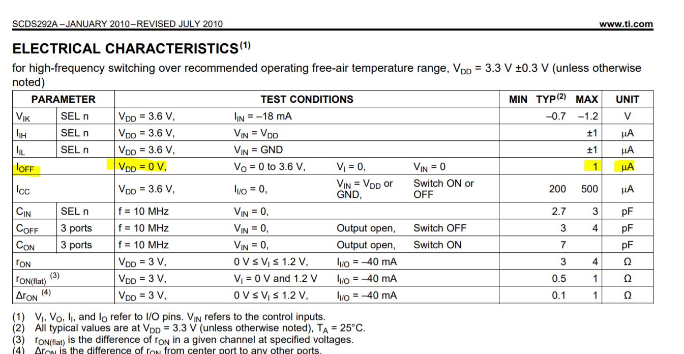

my customer wants to use the TS3V712E to multiplex between to interfaces AND be able to completely disconnect all devices. Since TS3V712E has no EN pin the only way to do that would be to switch VDD of the part off. But on the A side there are 3.3V 100k PUs. How would the part behave without any voltage on VDD but 3.3V on the A pins? Are all pins High-Z or would it draw some current?

  • Hi Smon,
    The Electrical specifications table has the Ioff spec at VDD= 0 ,
    It states the leakage current with VDD = 0V showing that the I/O signal path is Hi-Z.
    Saminah
  • Hi Saminah,
    the line is specified for Vo 0 to 3.6V (which should be Bx and Cx) and Vi = 0V (which should be Ax). So there is no specification for Vdd = 0V and Ax beeing pulled to 3.3V. Would this result in a bigger current draw than the 1 uA?
    Best regards
    Simon
  • Hi Simon,
    It should be the same (1 uA).
    Ioff is the maximum leakage current into an input or output terminal of the device, with the specified voltage applied to the terminal and VCC = 0 V
    The Ioff protection circuitry ensures that no excessive current is drawn from or to an input, output, or combined I/O that is biased to a specified voltage while the device is powered down.
    You can take a look at the spec in TS3V712EL datasheet - the main difference from TS3V712E is VDD_5  supply but it specifies Ioff with more detailed conditions.
    Saminah

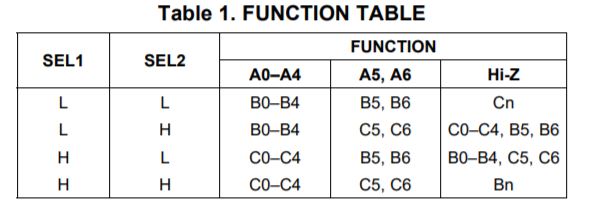

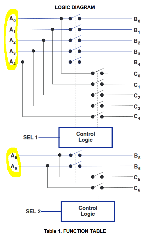

    There are two additional questions which are important for my customer:
    a) All switches are suitable for bidirectional signals, i.e. they conduct and block in both directions.
    b) The changeover switches with the indices 0 to 4 and those with the indices 5 and 6, are all seven identical?
    Simon
    Are you referring to these switches? The thread I included above shows some differences.
    Saminah
  • Hi Saminah,
    for questiom B I meant are the input A0 to A4 the same as A5 & A6 or is there a difference internally?
    Best regards
    Simon
  • Hi Simon,
    The Ax inputs are the same - the only difference is how they function based on the truth table (SEL1 and SEL2 logic)
    Saminah
  • Hi Saminah,
    thanks for the answer! Any upate on the Ioff spec?
    Simon
  • Hi Simon,
    As discussed over email, we'll run the test in the lab and get back to you.
    Saminah
