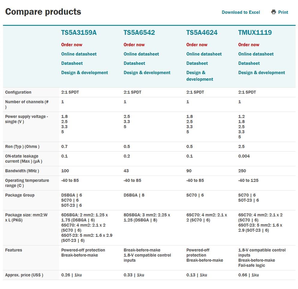

    If you do not need this built in translation feature, we have several 1:2 SPDT switches that do not have the built in logic translation.  I have filtered down the list here on TI.com.   We can narrow down the list further by identifying other requirements you may have.

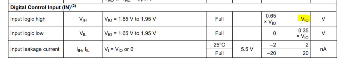

  • I read through the other post, I see a slight difference in configuration though.
    VIO will still be powered at 1.8V (not tying VCC and VIO together), so can the IN pin tolerate a voltage that is 1.2V higher than VIO?
    Thanks!
  • Hi Nick,
    No, If VI/O is 1.8V, max voltage on IN would be limited to VIO (1.8V) in that case.
    The other switches I highlighted above do not have the  logic level shifting and can support VIH > 3V.
    Saminah
  • Thank you!
    One last question. The other E2E post mentioned tying VCC and VIO together which means VIO can run higher than 1.8V. Can the device run with VCC at ~4.7V and Vio at 3V?
  • Nick,
    You can do that, but you need to make sure you still have valid logic thresholds as they are now being referenced to the new Vio = 3 V.
    In this device, the logic thresholds are referenced to Vio (some parts without 1.8V logic have logic thresholds referenced to Vcc)
    In a device with 1.8V control inputs, the VIH and VIL levels will be fixed to align with the CMOS 1.8V logic standard, regardless of the supply voltage.
