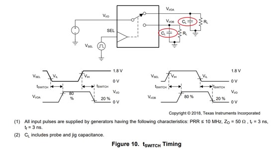

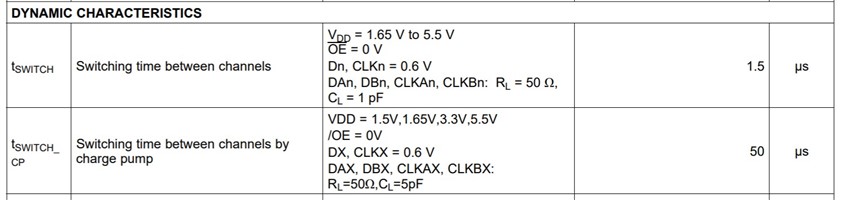

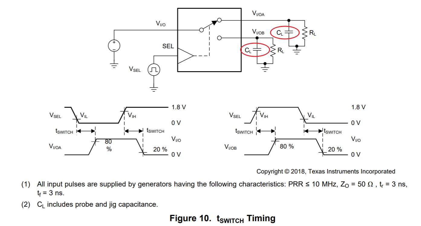

May I know how to understand the spec "Switching time between channels by charge pump" in datasheet?
Does it mean that the switching time when the CL changes to 5pF in figure 10?
Thanks and Best Regards!
